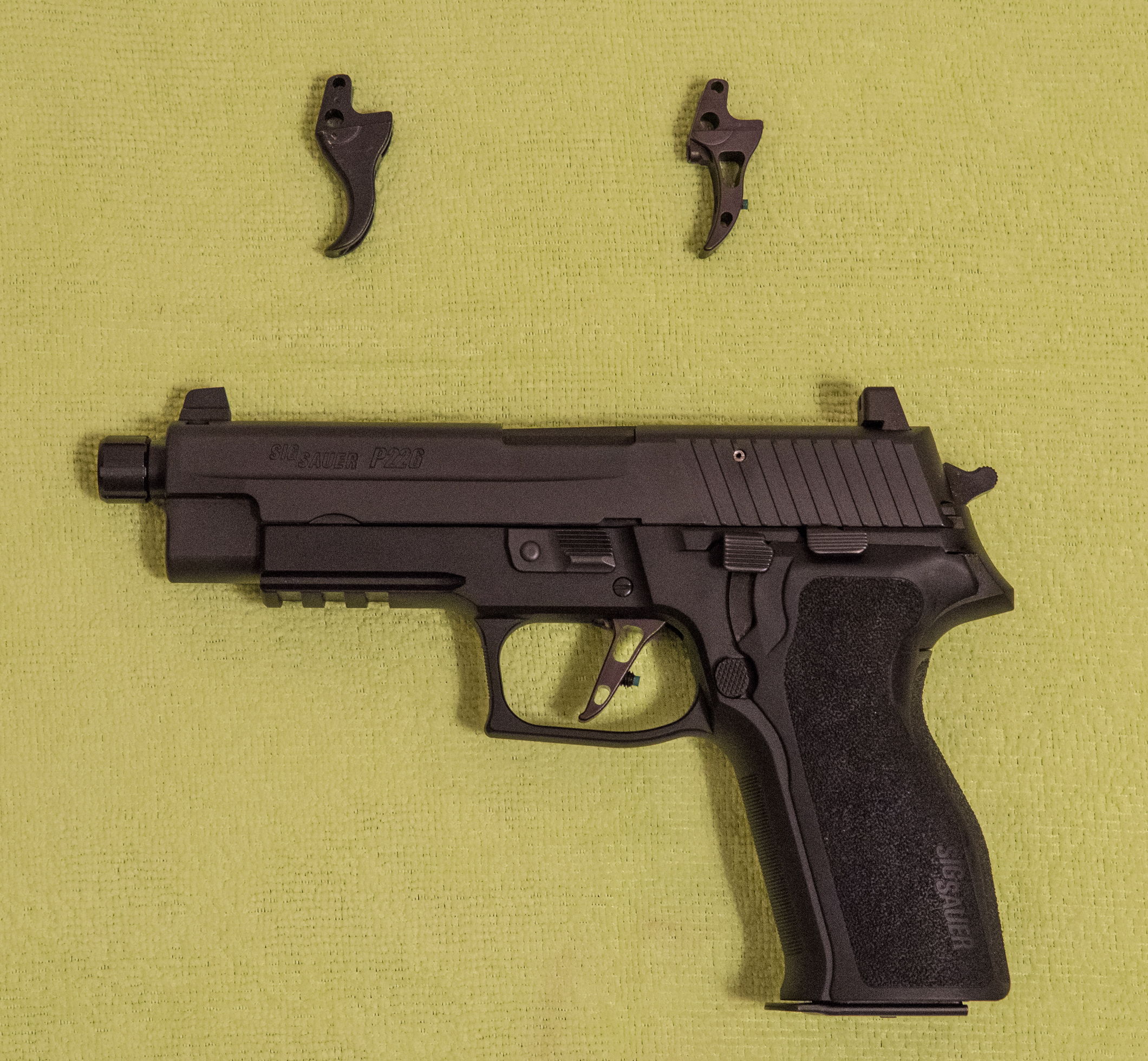

    The factory trigger
    The factory trigger to me was really spongy and the reset wasn't that good even though it already had SRT. It would get an "OK' from me but not a 'wow this is awesome'. The Armory Craft though makes me feel like I have a whole new gun. Definitely good stuff. Armory Craft makes awesome Sigs even more awesome by exploiting and overcoming a small design flaw/weakness of a small but most significant part.
    (In the pic the top left is the factory trigger. Top right is Armory Craft slightly curved trigger. In the gun is the flat trigger. Overall for my purposes the flat trigger wins. The feel and function is just fantastic. The curved trigger has the exact same function just a different contour. I bought both.)
