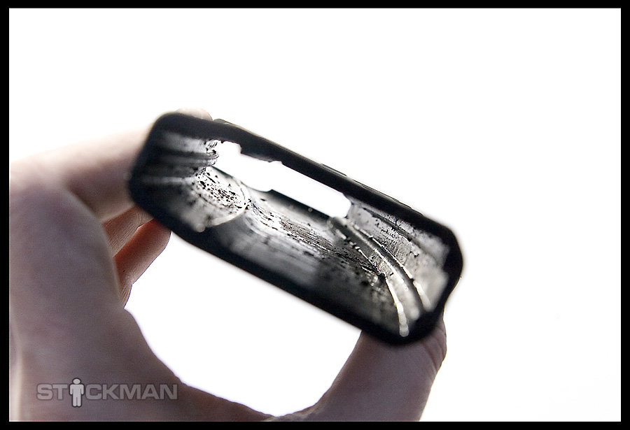

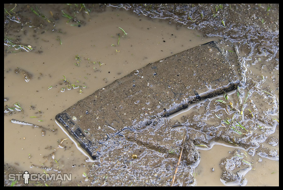

    The below magazine is one which was used during inclement weather work. Shootings don't stop just because the weather is poor, and we obviously need to train to fit the environment we may fight in. Its pretty obvious that a magazine that is used in conditions like this is going to need to be cleaned, and even though the pictured magazine was cleaned out in water after being dropped in the mud, you can see what the inside looked like at the end of the day.
    Yes, this PMAG remained functional, but there is little point hinging our life, or the lives of others on something that is easy to wipe down and keep clean.
    Name:  IMG_9696 Stick a.jpg
    Name:  IMG_9697 Stick a.jpg

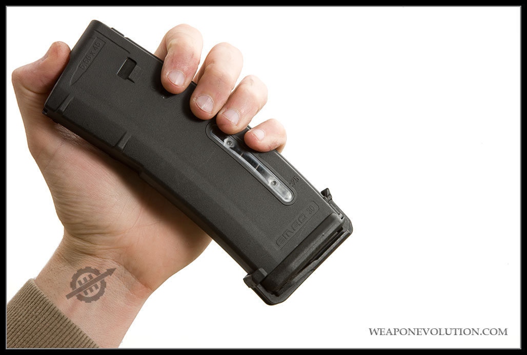

    We will start with the Magpul EMAG, though the PMAG is disassembled and reassembled the same way.
    First and obviously most important is basic weapon safety. If you have removed the magazine from a weapon, the magazine and weapon need to be unloaded. I'm assuming that if you are cleaning your mags, you are going to be caring for your weapon as well....

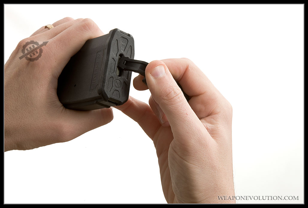

    If your EMAG/ PMAG has the cover locked in position, take it off by pushing up as shown below.

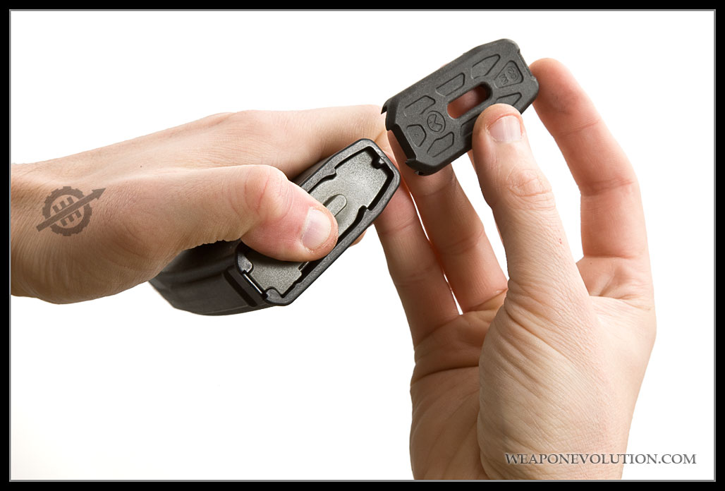

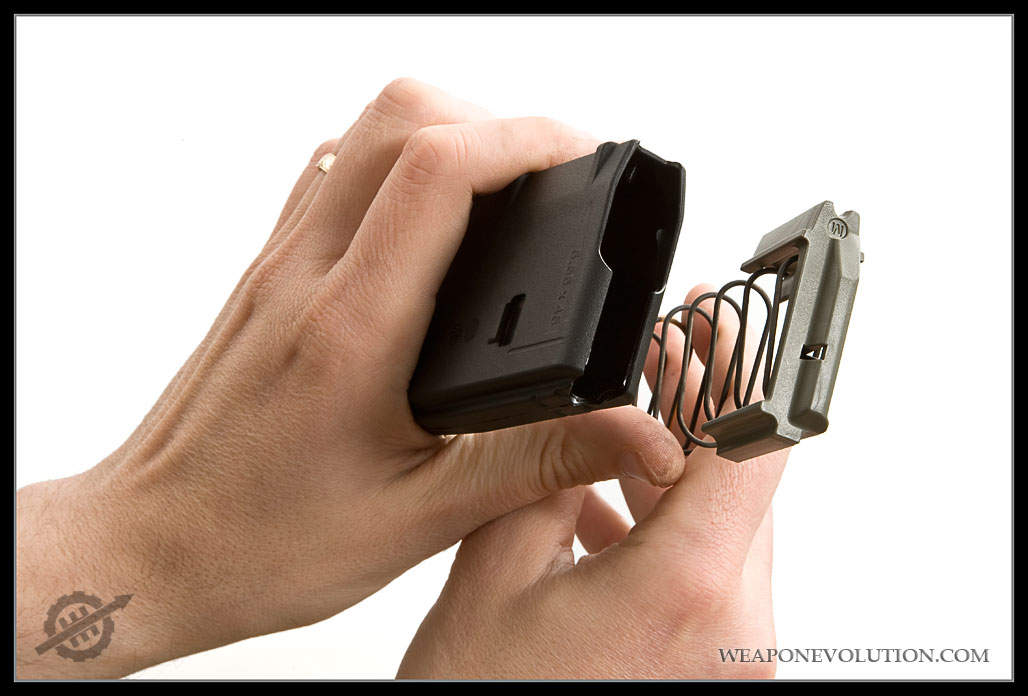

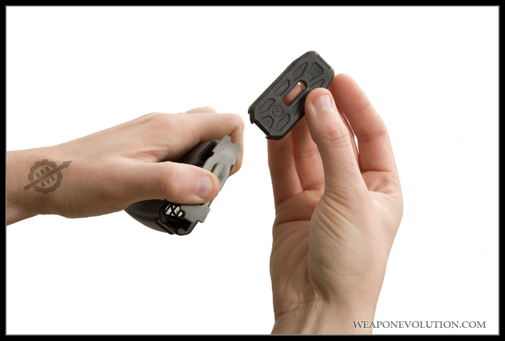

    Next we take the end of the cover, and press in on the center portion of the magazine base plate (which is the insert). We need to press this in, and then push on the base plate towards the front of the magazine. The base plate slides off, and the insert will attempt to launch itself under spring pressure if you don't keep your thumb or hand over it (image #2).

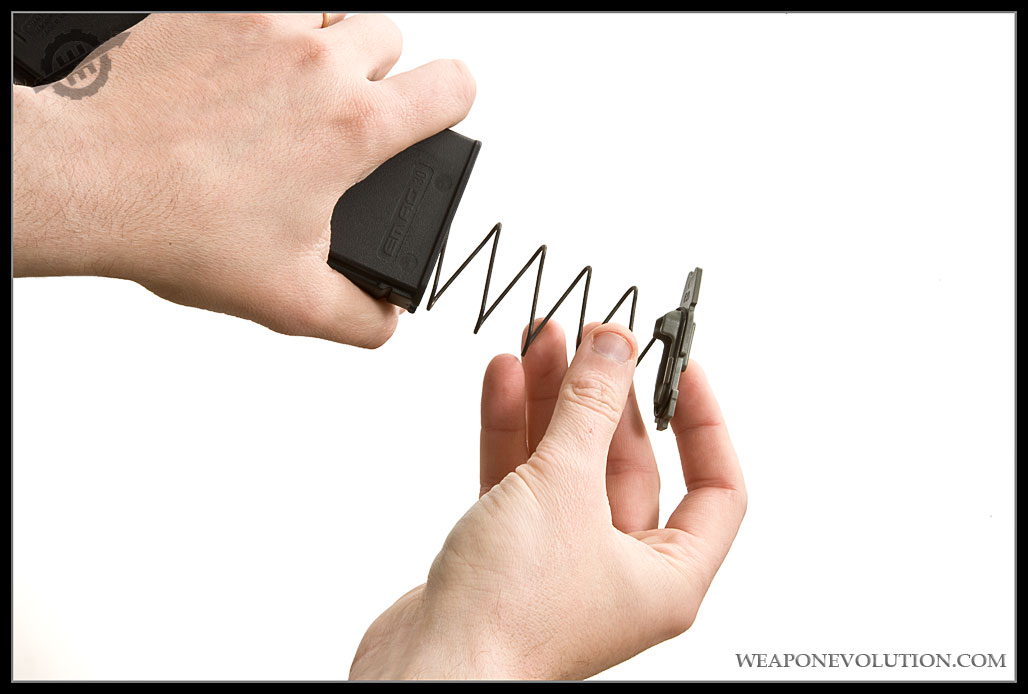

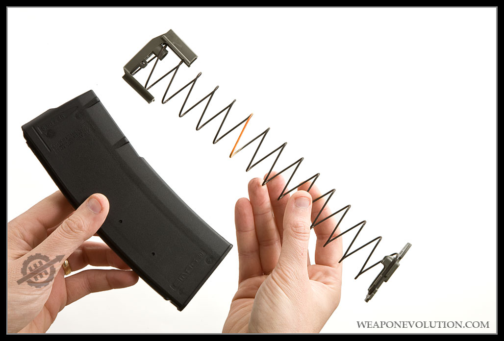

    Removal of the spring is accomplished simply by pulling it directly out of the magazine body. Unlike a traditional USGI M16 magazine, there is no twisting of the follower to remove it.
    This is as far as you will usually need to take the magazine apart to clean it. A clean dry rag is all that I use, unless I've been running a suppressor or something that is blowing carbon and junk into the mag and its all dried up.
    Regardless of how you clean it, remember that there is ZERO need to lubricate the followers, inside, or outside of the magazine body. For those people that like to lube their spring, you are creating a dust magnet. If you feel a strong need to lube the spring, I would suggest that you lube it, then wipe it back off after letting it sit for awhile.

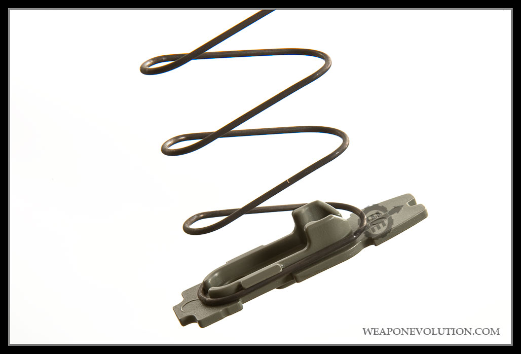

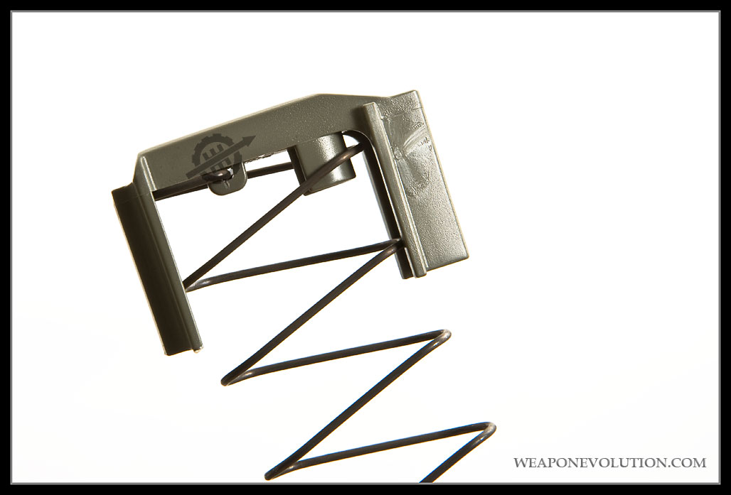

    One of the nice things about the newest (at the time of this writing) EMAG and PMAGs is that that the follower and magazine insert are captured, and retain the spring.
    The below pictures show how the spring engages these parts. They can be removed with little trouble, but most people aren't going to need to do that on a regular basis.

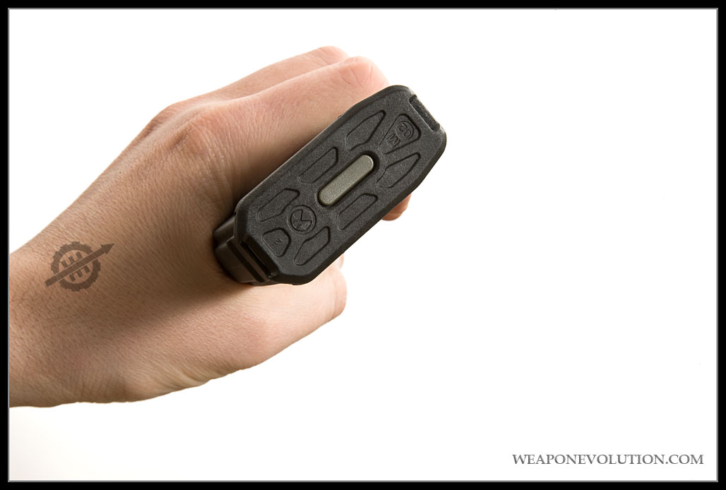

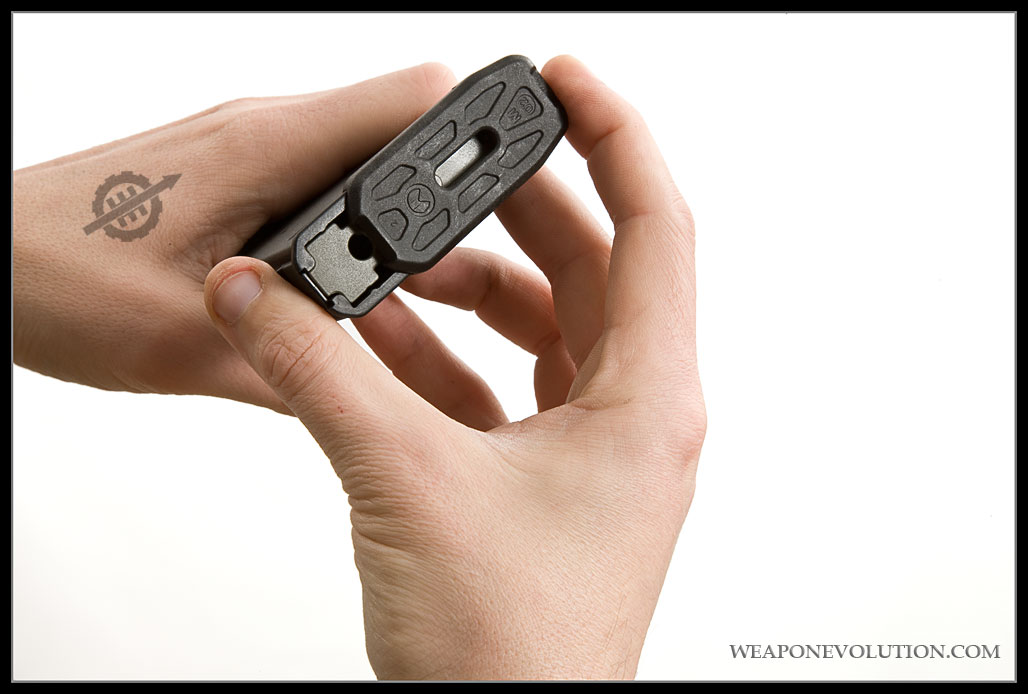

    About the only way something can go wrong with reassembly is if you press the base plate on and miss one of the edges, in which case it will simply pop off under the spring pressure. When pressed into place, the gray insert will lock into position with the base plate and shown below.

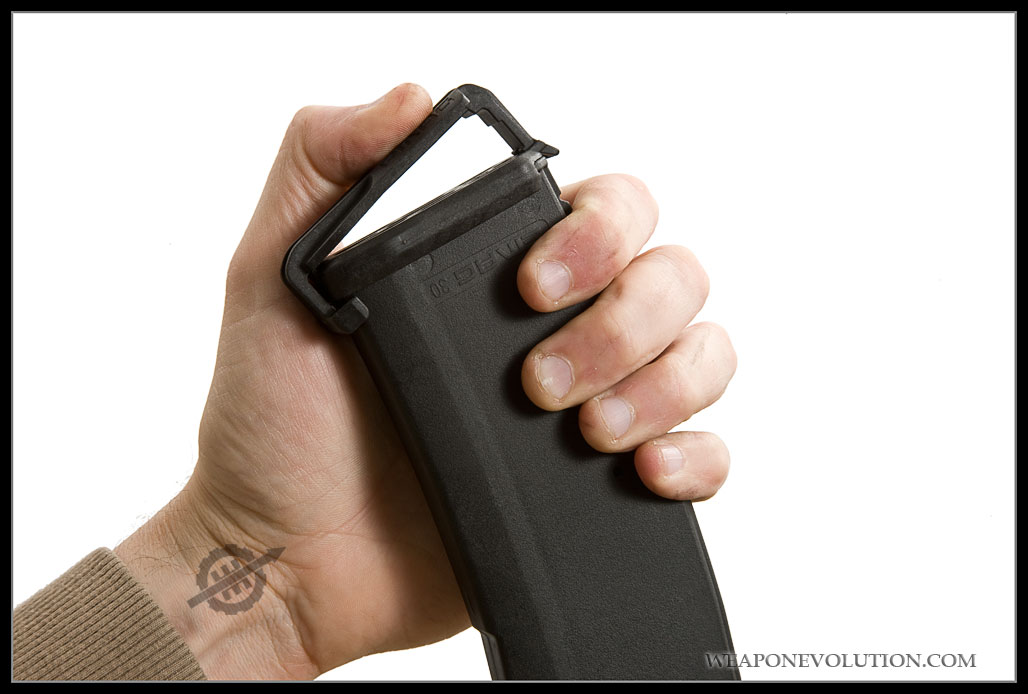

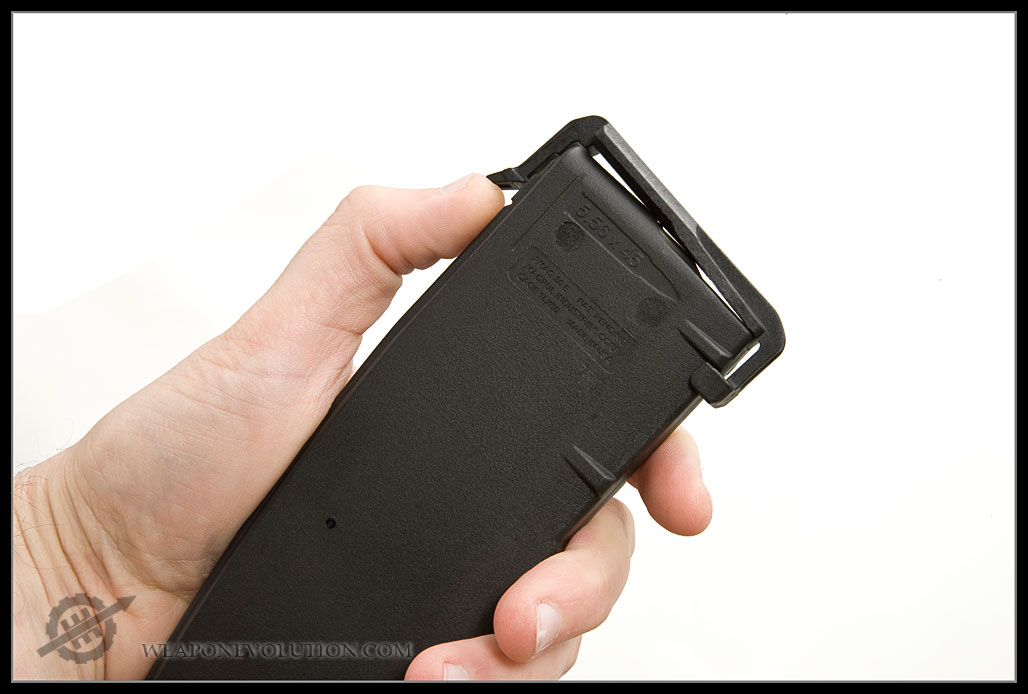

    We started with our EMAG using the storage cover on top to protect the feedlips. We will end with showing that the current generation of EMAG and PMAGs are now able to store then cover on the bottom of the magazine. For people who get upset when they lose things, this is a blessing.
    The cover locks into the bottom of the maagzine in the same manner that it locks into the top of the mag. Removal is the same way, and for me, I've found that locking the cover on the bottom seems slightly tighter than on the top. Of course this may just be me, and its not like there is much difference.
