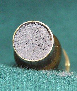

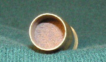

    Here are some pics that I found online of puff lon in the wild. These are not my pics but you get the idea. My puff lon though does seem to be a lot finer of a grain than these photos indicate but it might just be the close up view they took to show the stuff. Like I said, mine is kind of slightly more coarse than baby powder but with a unique texture to it.
    So far I have been doing a lot of various tests at my own chaotic and random pace. I am trying out cast bullets (see the other thread) as well as a few jacketed bullets. So far other than my cast bullets I have tested 180 grain jacketed bullets and a very few 190 grain jacketed bullets.
    So far the 180's...I would call a resounding success. I have gotten consistent subsonic velocity with full function of the gun with those rounds. With that one round I did a 10 shot string and my single shot extreme low velocity was 1028 and my single shot extreme high velocity was 1107. All the rest of the shots were consistently 1036 to 1085 in range. In that case I was using a soft point jacketed boat tail bullet.
    I am going to keep on trying various bullet weights too.
