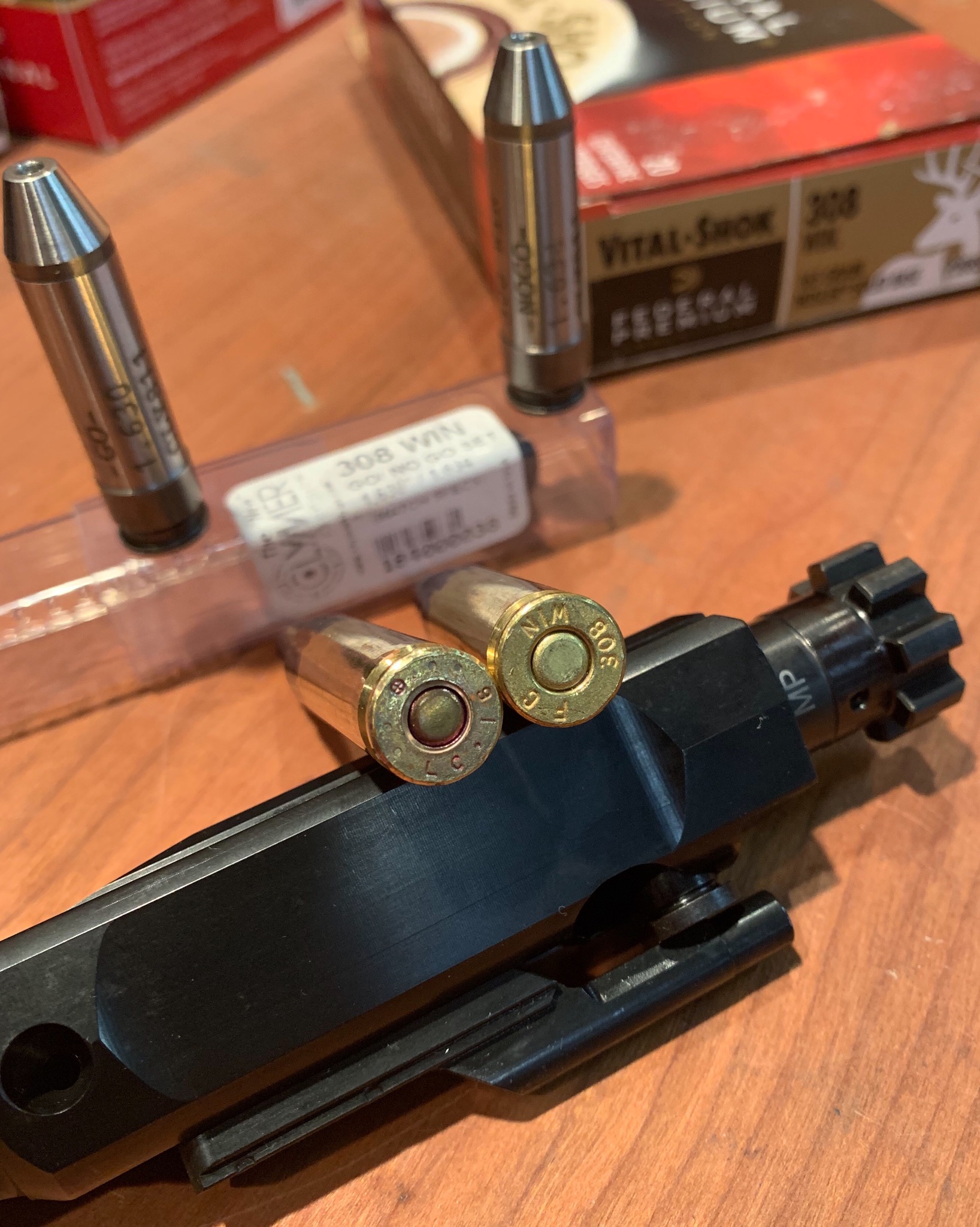

    Ok.. busy day and got the barrel and guages today, but snuck out to play once everyone was asleep.Follow along to what looks like a slightly tight chamber..
    Ok , using a slightly used Rainier arms barrel with hybrid chamber and brownells/supposedly toolcraft nitride bcg/bolt. The guages are Clymer .308 win , go guage is 1.630 and No Go is 1.634
    Barrel was cleaned and cleaned again. As was the Bolt , which was stripped down. Upper is not assembled, checking before hand.

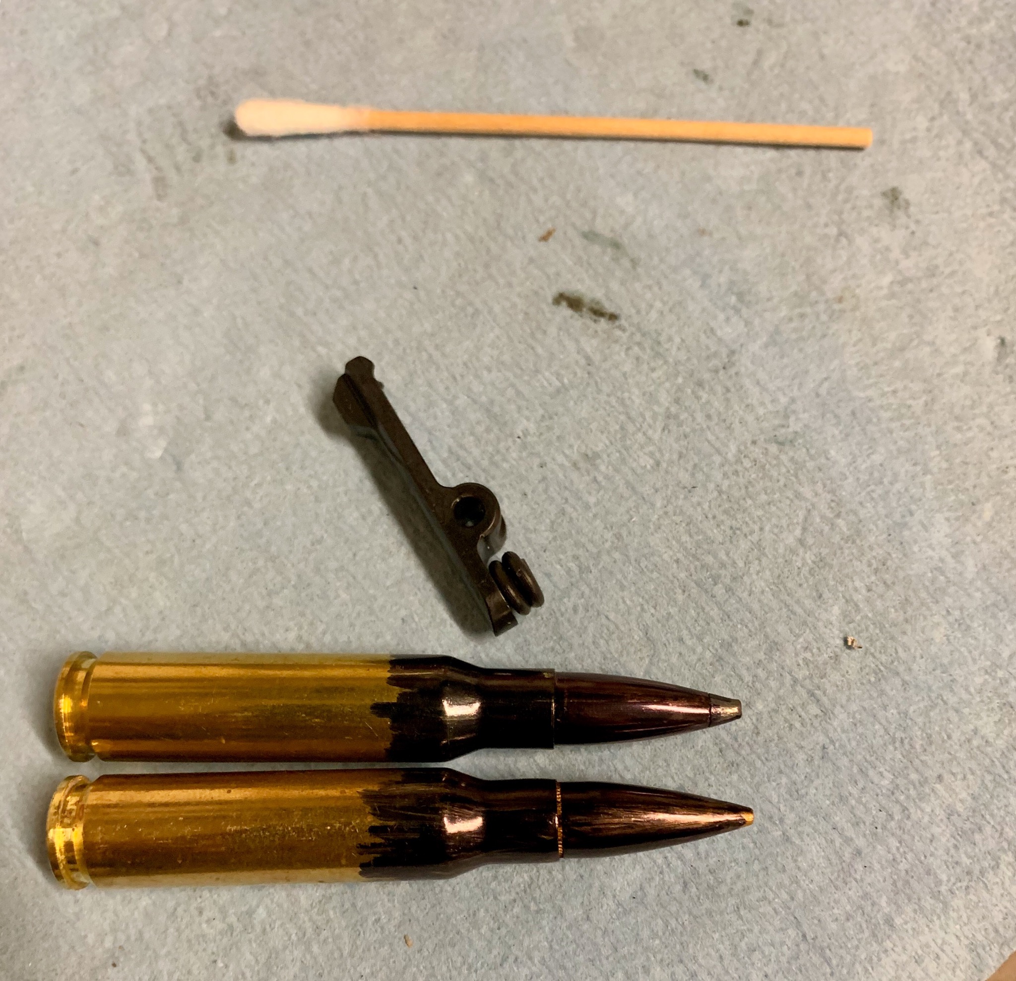

    Insert the Go guage and the bolt will not rotate, starts to but not all the way , put bolt into bcg and try again.It begins to turn but not all the way. Does not close on the No Go...So I was curious so if grabbed some ammo.
    Inserted a fresh .308 -federal 165gr and the bolt turns on it. Like butter. Throw in a newish LC 762 150gr rd and it turns but with some resistance.. Not a lot but itís not butter..
    Colored up each of them with a sharpie , in and out a bunch times, rotating bolt. They both are hardly even scuffed. My pic sux as it looks screwy thru the pic. but itís clean..but no gouges or scrapes like it was on the lands...
    So appears to be on the tight side..whatcha think?
    Attached Images Attached Images
