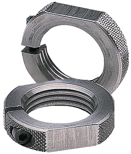

    Here on the other hand are Hornady Lock Rings:
    Name:  sure lock ring.jpg
    First off they are steel and second off they have wrench flats. You can tighten the dies down to the specific depth, tighten up the lock rings, then use a wrench to loosen or tighten them without having to loosen the ring itself up which would alter your die setting. With the Forster lock rings if they get tightened down too much or even a little bit you can't get them off by hand. With the Hornady it's no problem. Just use the same turret hole for the same die and tighten it up as needed either by hand or snug it with a crescent wrench and you're good to go. Caliber changes are about as easy as unscrewing a die and putting another one in it's place.
