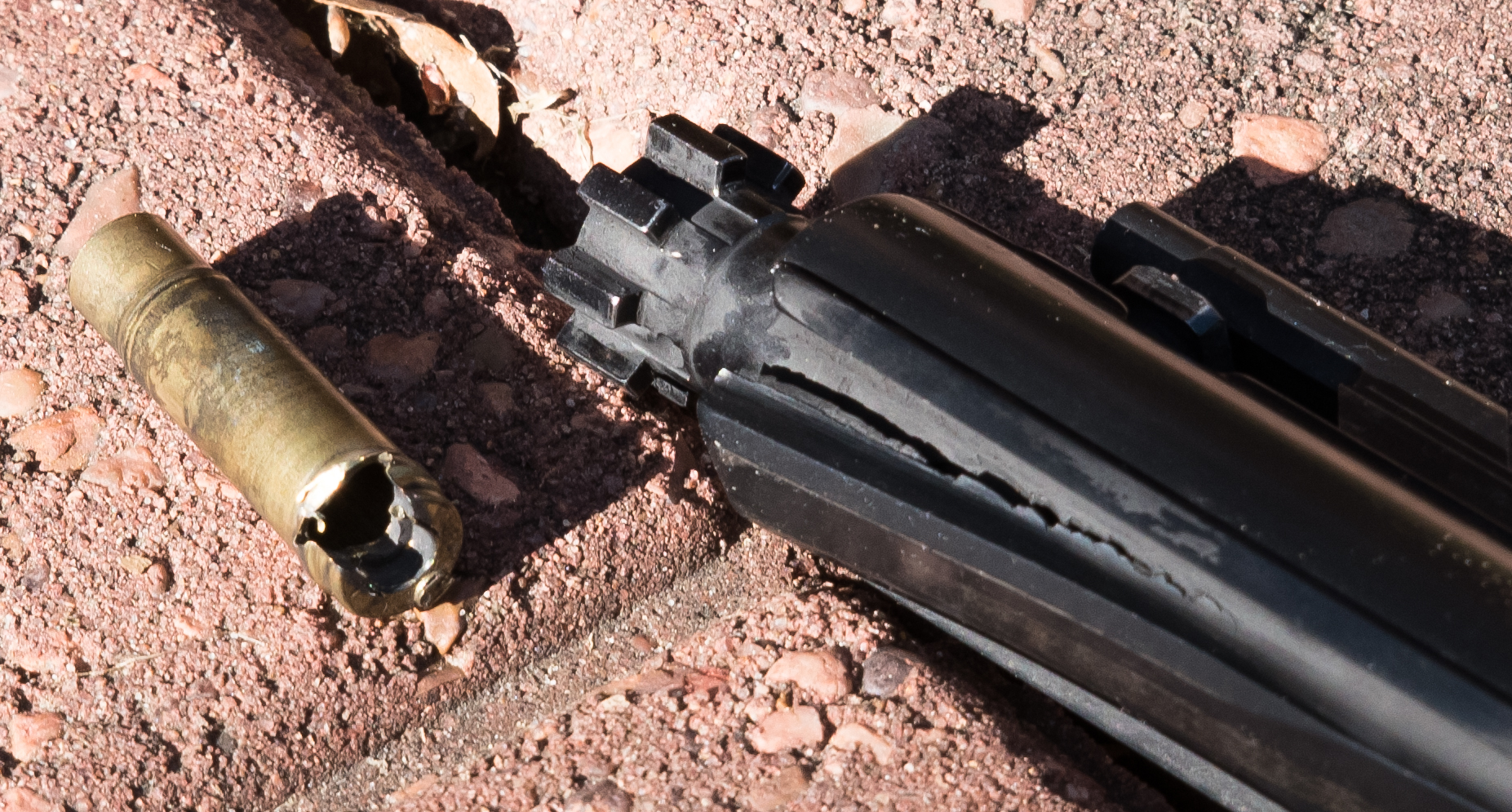

    I am normally an extremely meticulous reloader. I have been reloading no less than 15 years and probably longer than that. What happened here is the brass was home-formed brass made out of 223/5.56. The case walls (which became the neck) were too thick but after forming you could drop the empty case in a chamber gauge and it would look fine. Once a bullet was seated though it was too thick and would not fully chamber. It was basically an out of battery detonation. It was out of battery just enough to where the bolt was not locked so when it went off it jammed the bolt into the carrier and split it.
    In no less than 15 years of reloading all the time this is my first accident. Not cool.
    It took me about 4 hours to remove the bolt and carrier from the upper. I broke everything down into pieces including removing the barrel (for inspection purposes) and it appears like this bolt carrier group is the only casualty here.
    Attached Images Attached Images

    Thanks. No digits lost. First accident in at least 15 probably more like 20 years of reloading. It was bound to happen but ammo wise it was from something hard to detect until it was too late.

    I am not sure the brand of brass because the base of it largely got messed up. When the brass was formed you could drop it into a case gauge and it would drop in freely. It would pass that test. When you load a bullet into the case though the neck thickness was just thick enough to prevent full chambering.

    The bolt was still in the extension and only held in place by some tiny shards of brass that were lodged in there. That's what took me so long to get it out. Most of the explosion was actually quite contained but yes it did blow the magazine out. Visually there is no damage to the mag at all. Just a lot of soot on it.
