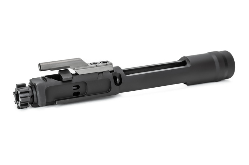

    Apparently Griffin introduced a new type of BCG geared at increased suppression in AR platforms.
    https://www.griffinarmament.com/grif...eid=b47d68033e
    The ports are located on the opposite side of a regular carrier and it has different geometry to prevent carbon buildup.
    According to the literature on an 18" AR it reduces the right ear noise by over 10DB. Essentially it does dump gas to the inside side of the BCG and acts sort of like a temporary short term baffle that helps with gas dissipation.
    I just saw this online so I'm reading more about it, but it does look interesting for sure. They are saying that the effects are highly dependent on gas length so we will look into that more.

    After sleeping on it, this package has numerous layers of benefits.
    If you opt for the whole package with the spring and bolt and buffer, it is a rough equivalent of a roller delayed system. The carrier itself travels something like .25" farther back and the bolt itself has a longer stroke. The net result is a little bit slower bolt opening. This reduces open the bolt under peak pressure.
    The cam pin and firing pin are proprietary as the inside geometry of the cam pin is beefed up. However the OD is not altered so the carrier is reverse compatible with anything else standard mil spec.
    Where the primary sound reduction happens is changing the size and location of the ports, which are traditionally located on the right side of the bolt and vent straight out into the outside air.
    In some of their old tests of other products over the years left them knowing that small ports can increase sound signature a lot.
    In one example, many years ago they were testing a muzzle device that had some small ports on it. With a bare muzzle the rifle metered in the high 160's. Same exact setup except adding that muzzle device that had the small ports and the sound signature increased to the low 170's.
    Basically put the size and location of those ports on a traditional BCG are increasing port noise just by virtue of their existence, shape, and location.
    So they moved them.

    Here is another thought process regarding gas. Look at the picture above. The gas is not just redirected, it's given somewhere to go. It has a pocket, where at least in theory, the gas has momentum going backwards and down. It's not being trapped but rather redirected. I theory the wall of the upper and the geometry of the left side of the carrier creates a somewhat sealed pocket.
    Except in this case that pocket is not static. As the gas is released in the pocket, the carrier will physically move backwards and somewhat follow the gas. This will slow down the gas while it expands, but any residual gas pressure on the tail end of the sequence will push the rest of it downward.
    It's not like a system where you quickly pressurize a loosely fitting vessel and in turn it looks for the path of least resistance.
    Even though there is 'new gas' in the upper that wasn't there before, it seems like it should use the gas' own momentum in a more efficient way to help change it's course.
    It's not fighting the system in a head to head battle but rather "pit maneuvering" the gas using its own energy to relatively gently redirect its path.

    But now it's blowing crap down into the mag and the FCG, based on that picture.
    The proof is in the pudding, and if it's less gassy, great, but it looks like you will still have to pay for that benefit somehow. At least the Bootleg pushes it out of the gun, though it can still come back at you.
