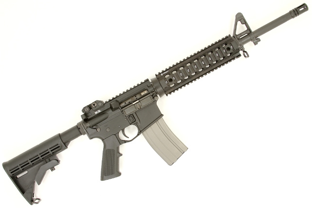

FRONT AND REAR FLIP-UP BUIS:
Front and rear flip-up BUIS is the most versatile set-up and gives you the greatest flexibility.

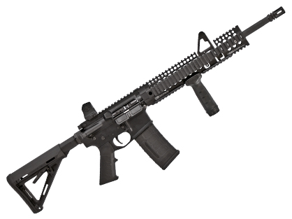

FIXED FRONT/FLIP-UP REAR BUIS:
This is one of the most popular set-ups because most AR's come with the fixed front sight base, which is pinned and very rugged.
