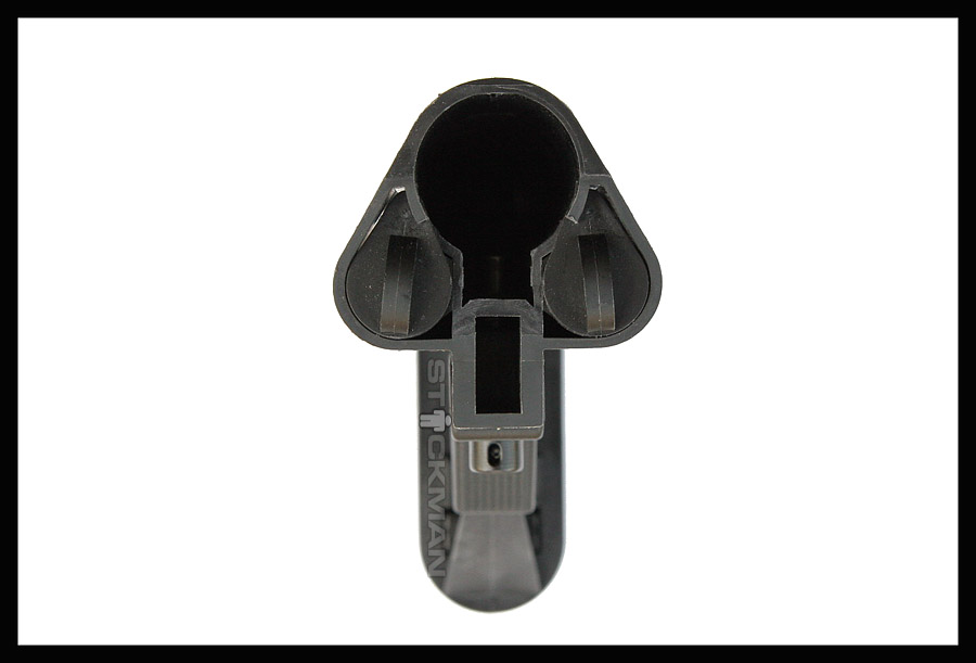

    Magpul Advanced Combat Stock (ACS)
    The Magpul Advanced Combat Stock (ACS) is designed for weapons using a carbine receiver extension (buffer tube), and offers battery storage in the form of two AA or 3 CR123 batteries in each of the two storage tubes. The battery storage tubes extend to create a larger cheekweld for the user. In addition, there is also storage in the trapdoor, though unlike the battery storage compartments, the trapdoor storage is not waterproof (but is water resistant). The trapdoor storage area can hold a boresnake, ear plugs, small batteries, or other smaller sized items.
