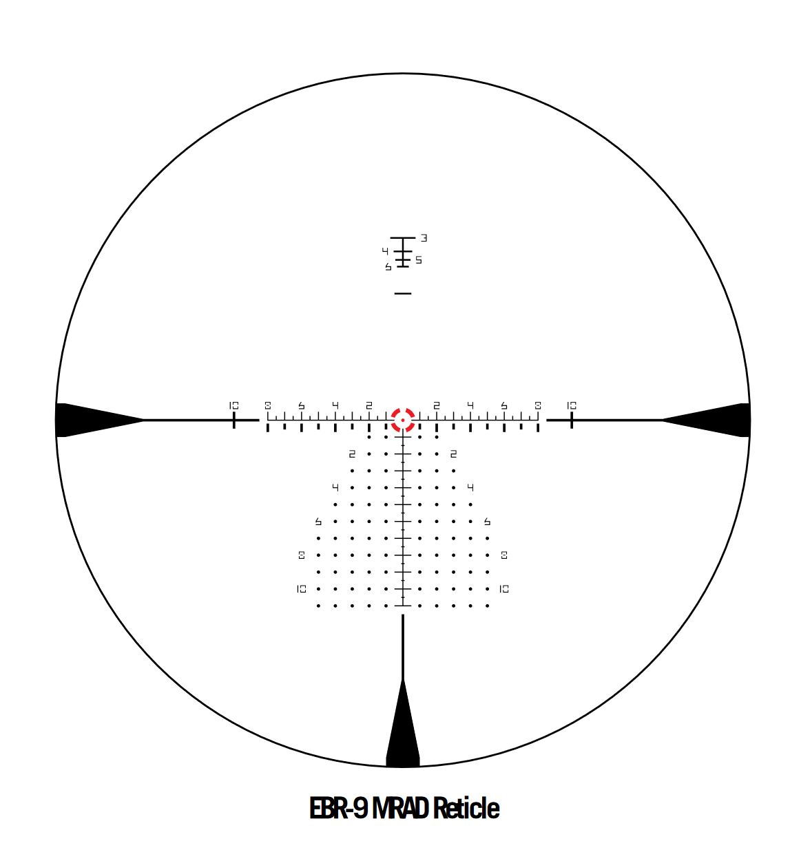

    LPVO Options?
    I am trying to locate some options for a LPVO. I am not particular if it's 1-6 or 1-10 or 1-8 or whatever. That said I am somewhat particular about the reticle options. The picture I attached is the type of reticle I would like. I do not want any type of BDC reticle though. A BDC reticle is a non starter. Also it must be in MILs.
    The whole idea here is to convert all of my rifles over to a MIL system and that rifle so far is the lone holdout.
    So far the only option I have found is the Vortex Razor Gen III 1-10.
    I would prefer not to spend $2500+++ for an optic right now... but if I can find something decent I will start putting some money aside and make that my next goal.
    Please let me know if you know or learn of something that fits this bill. It doesn't have to be that exact reticle, just something similar.

    The ATACR has as similar reticle layout, minus the ranging etching. Street price on the ATACR is still more than the Razor 3, however. You can find the Razor 3 in the $1800-2K range currently, and they're actually in stock. Both the Razor and the ATACR have a capped elevation turret that isn't not designed to be used quickly. Not that it's a deal breaker, but just something to know ahead of time.

    A FFP LPVO with a Christmas tree / Horus style reticle is typically only found on more recent higher end options because it really doesn't start making sense until you get to at around 8x. I'm eyeing that Razor 1-10 for my LMT MARS-H. Street price for those is under $2k and they are really competing with the more expensive ATACR and Kahles and Leupold Mark 8

    I am always tempted to just treat everything like it's a long range rig but I am definitely resisting. I learned a lot in studying out the particulars of this AR (my first one) and I do not want to change it's purpose.
    I don't know all the military terminology but I would say my setup is based on a Recce mindset. That being a rifle with the ability to ID targets at longer ranges. That said a longer focal length would be welcome.
    To gator's point, having 'daylight bright' illumination would be awesome but my experience tells me that isn't always the case, especially with not so high end optics. My Aimpoint RDS are all awesome but I have a feeling that if I want that same performance in an LPVO I will have to sell a kidney.
    Before I was focused on shooting groups and all that, and with this particular rifle I can hit targets relatively reliably out to 800 yards. Now though I tend to shoot more based on PRS type shooting. Shooting off of a fence, around trees, kneeling, whatever. I think the latter is more applicable to what this rifle is set up for. To me it is a much more practical use.
    I don't like BDC reticles because none of them match up with my load at all and trying to remember oddball data is a pain in the ass. Being able to accurately hold wind is to me another important thing. If I am holding off in space not knowing really what I am holding isn't really any better than what I have now. In a way it's holding me back (with that rifle) from learning.
    The ATACR and that new Eotech both look perfect. If I am not dialing elevation that's fine. Once I get it setup that might be a good thing. I don't mind using hold overs at all. Anyway I don't have to change my optic under any time line. It's worked for this long. That said I am keeping my eyes open.

    I love the EBR-X reticles, too, but I don't think one would be really useful below 8x and for 5.56 you probably aren't engaging beyond 600 and 6x is fine. So, what you are chasing makes sense to me for calibers with longer effective range like .308 but I'm not convinced its particularly useful for a 5.56 recce. That Vudu does look attractive, but I'd be surprised if the glass in comparable to the Razor. From what I've heard, EOTech just isn't there yet but maybe they'll surprise us. And if an ATACR was in your budget this thread wouldn't exist.
    Sorry, but this isn't making sense to me. At the end of the day, your scope will have little marks on it that correlate to distances for your ammo and your options are either to remember your holds or use a ballistic calculator to solve for the hold before you take your shot. BDC reticles attempt to correlate those marks to common ballistics to increase speed and simplicity. In either case, you're going to have to figure out your dope on a table like below, regardless of how far apart those hashmarks are and frequently your targets will be between the hashmarks no matter which reticle you chose.
    The Mil/MOA vs BDC is a red herring for LPVOs at short to medium ranges as far as I'm concerned, and a BDC for 77gr SMK for a 5.56 Recce seems pretty darned practical. If you're off, you probably aren't off by much. Now, for long range where you're working with a spotter it's a whole different story. Note that the new Razor 1-10 gives you the option of mil based Christmas tree or MOA based BDC as that magnification range puts you into a bit of cross-over.
    Lastly, the whole point of EBR/Horus/Christmas Tree reticles is so you don't have to dial so I generally I expect them to have capped turrets. If you don't like that, just leave the caps off.

    I get that. I had a BDC reticle before and honestly I didn't like it. Who knows. I've gone full circle on a number of things before so this wouldn't be the first.
    For me, I am typically not shooting a hodge podge of various ammo. I load every round pretty much. I have that load, that DOPE, etc all pretty much down.
    Quote Originally Posted by BoilerUp View Post
    Given the right reticle I won't need to dial. The more I look at it the Razor, or at least the reticle, is perfect. I can engage to 800 yards in over a 12 mph wind without touching a knob, which is as far as I can accurately hit with that rifle so far. But like everyone says, I typically won't be shooting that far.
    Quote Originally Posted by gatordev View Post
    I didn't mention the NX-8 because it seemed like the Xmas tree reticle was part of the requirement,
    At this point it's a preference. I wouldn't go so far as to say 'requirement' yet. Apparently some people prefer the Christmas tree otherwise Night Force, Vortex and Eotech wouldn't be making them.
    I would definitely welcome more zoom so a 10x would be great, but I am not looking primarily for zoom. 8x would be fine as well.
    Capped or tatical turrets are not an issue. Like I said above with that particular 1-10 I can do 100% of my shooting with holds. For those longer range shots (more importantly in the wind) I won't be off in dead space just hoping I am close. I can do hold overs and hold in dead space now with the optic I have so at least so far to me, moving to a different optic with some of those BDC reticles is a lateral move minus maybe a bit more zoom and maybe just a higher quality of scope.
    Some of the other options have a decent compromise, but they are just that--a compromise, not what I am actually in theory after. Hence the thread to see what the market has to offer. At this point it's all research so my wants are subject to change as I learn more.

    A Christmas tree as of right now 'seems' like it is my better option. That said absolutely nothing is written in stone. I went car shopping not too long ago hell bent on buying X but in the end after taking everything into consideration I left with something else. This optics question might be the same thing.
    The last BDC I had was a post with some hash marks on it. If I recall it didn't even have any horizontal lines, marks, or reference points in it. If I needed to hold off some I was basically just waffling around in space guessing. That said there are others out there that do have wind holds on the reticle and I probably would have liked those a lot more.
    If I can increase zoom I am completely open to that. Having 8x vs 4x is an improvement for sure.
    I don't see myself as being completely married to the idea (or almost any other thing) but it is my first option as of now.
    A secondary reason is that, like I said above, I like the idea of having cross over skills. Shooting everything in mils but then having one oddball where I need to convert to moa on the surface seems like a good thing to avoid.
    Learning how to read conditions is something I am trying to learn. "This is what a 5 to 7mph wind looks like" and with X bullet I need Y hold off... It just seems to me that sticking with the program is a lot more efficient.
    Basically that kind of sums up where I am at as of now. There might be something better out there. I just don't know what that is yet.
