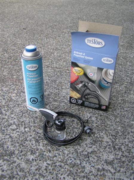

    I've been asked a few times about refinishing AR15s. I don't claim to be an expert, but mine have turned out well, and seem to be holding up to wear quite nicely. Here is how I do it.
    To start, I picked up an airbrush kit. I had been told that ANY basic airbrush would work fine for spraying Norrells Moly Resin, so I went with the most basic version I could find. Oddly enough, that also meant the cheapest version I could find. Out to the local stores, and the Testors kit pictured below is what I am using. As it turns out, this little cheapo airbrush works very well.
    Inside the box will be a small air canister, go ahead and pick up a larger can while you are there. Sooner or later you will need it, and the middle of a project is a bad time to go low on air...
    Price for Testors Airbrush Kit-$20-25
    Price for large air can- $6-7

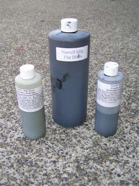

    Next on the list was to actually get some product to spray. After checking around and reading just about every review I could, I decided that Norrells Moly Resin would be the best finish for me.
    http://www.johnnorrellarms.com/
    Colors
    Prices (including shipping)
    $ 25.00 / 8 ounces
    $ 50.00 / per quart
    $150.00 / gallon

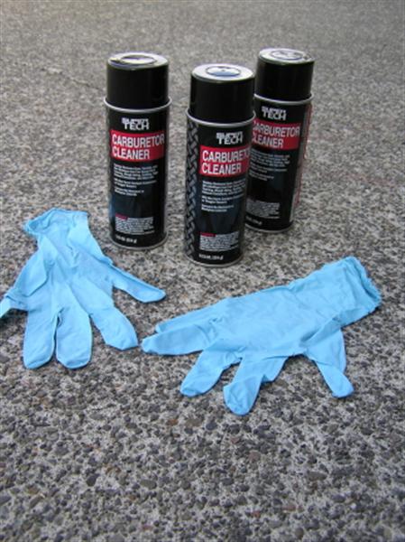

    Last on my supply/ shopping list was degreaser and gloves. Actually, for a degreaser I picked up a bunch of carb cleaner cans for $1 each. They grab all the oils out of the steel, which is exactly what we are looking for. They also evaporate quickly, which is nice when we are trying to get work done.
    Latex, or a similar type of glove is recommended so you don't paint your fingers. More important than you coloring your fingers, is that the oils from your hands/ fingers gets all over the metal as you are trying to spray it. This negates all the hard work you did on degreasing. Kind of pointless to not wear gloves...
    Price for Carb cleaner-$1 each
    Latex or dish gloves-$1 for a few pair

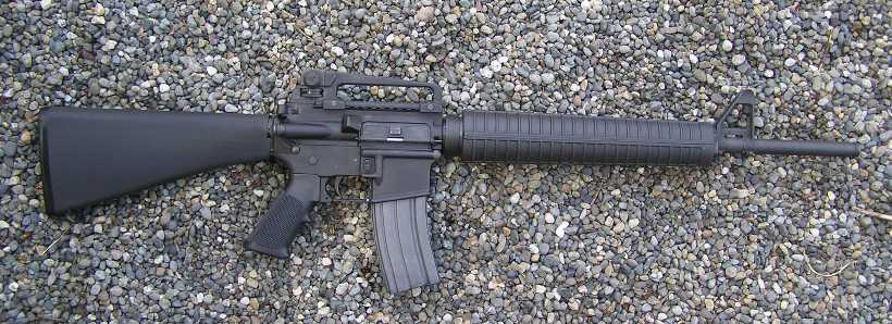

    Here is the AR15 we are going to refinish...

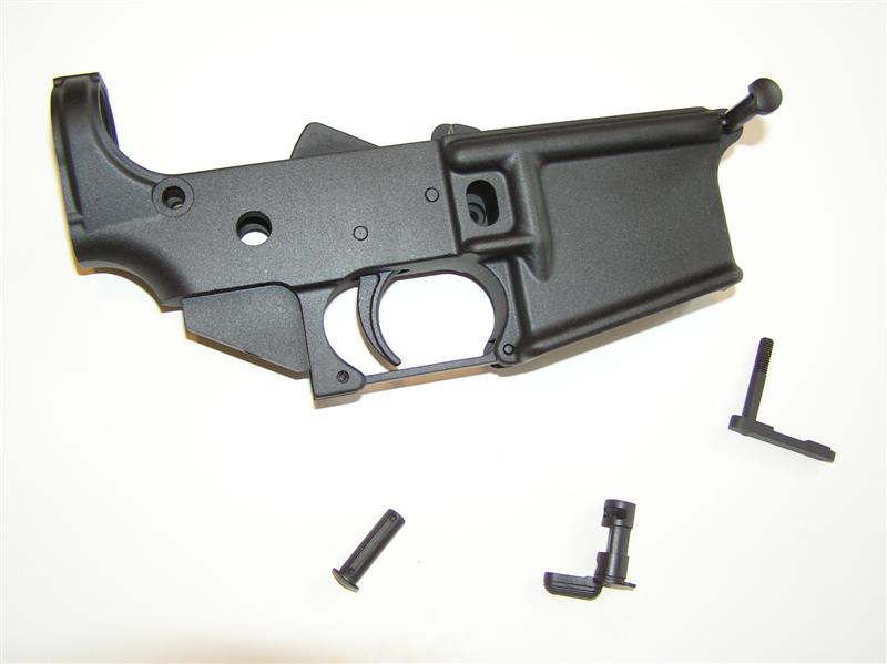

    DISASSEMBLY
    We are at a point where we can go two different ways with our refinshing. We can take everything apart, or we can break down what we feel is needed.
    For this example, I figured I would pull apart what I felt was needed to make this a quality refinish, but without getting carried away and making this an all day job.
    Norrells comments that a weapon does not need to be torn all the way down, and that it can actually be coated in its assembled form.
    QUOTE
    **Taken from Norrells website**
    Firearm Disassembly:
    Moly Resin™ may be used for cosmetic refinishing and/or as a protective coating against the elements. When used solely as a cosmetic finish, it is unnecessary to completely disassemble many firearms to refinish. In many instances a large sub-assembly of parts may be coated without disassembly.

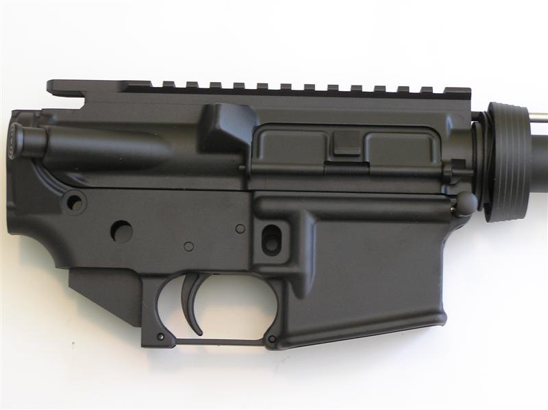

    At a minimum, I would recommend taking off the stock, pistol grip, and handguards. If you are afraid to pull any of these pieces, I would encourage you to visit AR15.com, and check out the assembly/ disassembly pages. If you are looking to coat the furniture, I would still recommend pulling them off.
    This is the lower receiver after being refinished, you can see I pulled the stock, buffer tube, pistol grip, handguards, mag catch, rear takedown pin, and safety (selector switch).

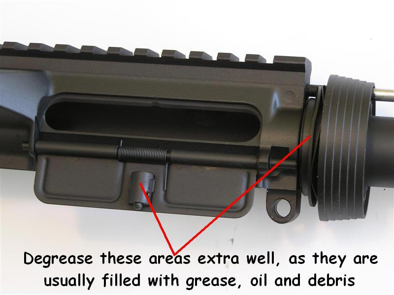

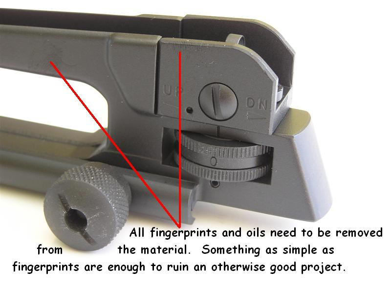

    DEGREASE
    Now is the time to get out the gloves, and start spraying things down. I would do this outside if you value your brain cells. Don't go easy on anything, it is only a buck for the can, and it is important to get all the oils out of the metal and finish. Spray it all down, then spray it again. Pay particular attention to the areas where there are cracks, joints or seams. Your front sight assembly, Delta ring, and the inside of your ejection port cover are all areas that will need special attention.
    Once you have it all degreased, hit it one more quick time, just to make sure.
    Are you finished? Are you sure? If you have any doubts, now is the time to go back and recheck. If you are doing a weapon that may have been in grease or cosmoline, you may need to preheat it in the oven. Leaving it in the oven for 30 minutes will bring anything out of the pores that may be lurking about.
    If you look close, you can see fingerprints on the upper portion of the carry handle and sights. This would be a mistake to spray it in this condition.

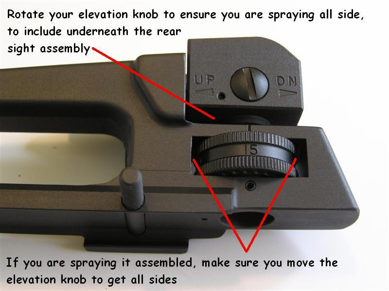

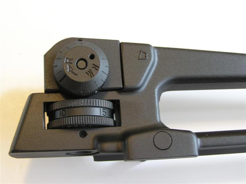

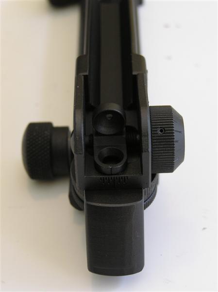

    AR SIGHT HINTS
    The sight assembly seem to be a sticking point for a few people. I've done a few by pulling them all the way apart, I've done a few by leaving them together, and I have done a few by pulling the A2 Sight Assembly off the carry handle. I can't tell them apart anymore, with the exception of the ones I have done in different colors.
    The end result is that if you preheat, and move the adjustment knob up and down, it is going to turn out fine. If you like the idea of having your rear portion of your sight a different color, it isn't that hard to pull the sight off the carry handle. Just remember where all the little springs and ball bearings go, because it doesn't work right without them. The manuals online can help you if you get forgetful.
    This is a rear view of the A2 sight on the carry handle after it has been coated.

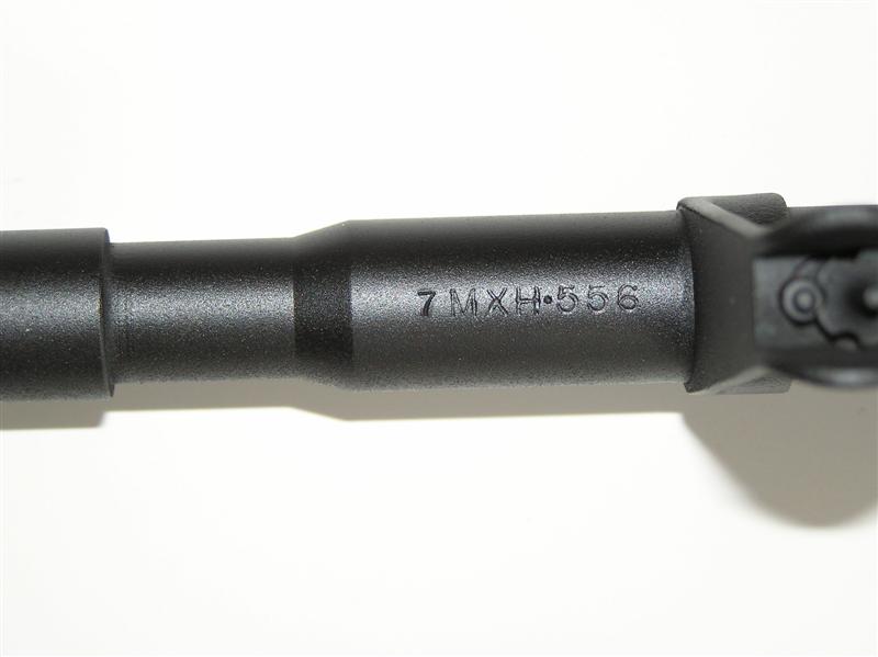

    BARREL HINTS
    The barrel is a pretty simple piece of the weapon to do. I spray up and down when I do a barrel, mainly because the spray pattern is football shaped. It gives me a heavier coverage, and I waste less doing it this way. Under the handguards gets three coats, but the sight assembly forward portion of the barrel get a little extra. I figure this portion of the weapon sees a little more wear than much of the rest of the AR.
    I coat the flash suppressor separate from the barrel, but there is no reason why you couldn't do it all assembled. If I were doing a completed weapon, I would do it together.
    There is no reason to get super excited about protecting your barrel when doing this work. A simple Q-tip or other similar object down the barrel will be more than enough to protect it. If you are leaving a FS on the end of your barrel, it should be a moot point.
    If you are coating a bare barrel, I would simply spray at an angle. You don't want to be spraying directly into your barrel extension, or chamber. I have found spraying from the side is is a fine way to avoid overspray into these areas

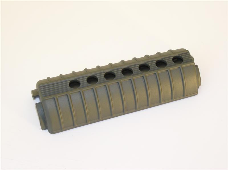

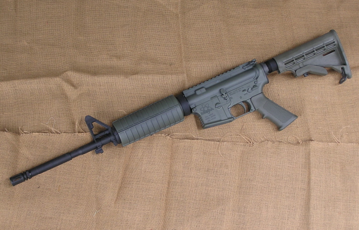

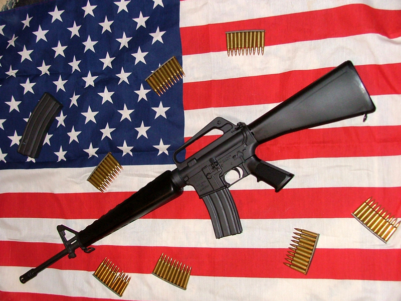

    A little info on plastics and colors....
    Here is a picture of the Norrells OD Green on a project I built, in this case I did the M4 handguards in the same color as some other parts of the weapon. A lot of people have been sending me questions asking how the Norrells adheres to plastics, and if the heat will damage anything.
    The end result has been that the product is holding up very well on the handguards. Prep work was simple degreasing, nothing else was done. As with everything I coat, I preheated it with a hairdryer before I sprayed.Here are some pictures of a little work I recently did. I have picked up a regular compressor, and adapted it using some (comp x npt) fittings available at your local hardware store. The compressor was set for 30psi when I sprayed these, and I worked them a little differently than usual. By warming the item higher than usual, the finish becomes very flat, and for the OD Green, this seems to look even better.
    Plastics were baked at 250 for 90 minutes, while the rest was at 300 for 60 minutes.
    Its worth noting that not all plastics take heat very well, especially some of the cheaper grades. This is why we lower the heat and extend the curing time. Times can be extended, and temps can be made lower. I cured a knife blade that had a bone handle at 200 degrees for 2 hours, and it turned out fine, but I did have resin/ glue seep from the handle.
    Any time you are refinishing, you are taking a risk. Then again, you take a risk every time you get out of bed in the morning. Whether the risk is something you are willing to take is up to you.
