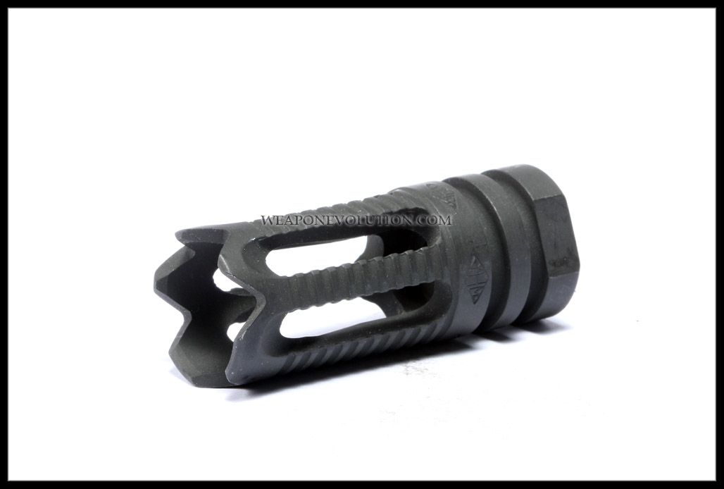

    YHM Phantom
    Please note that the Phantom is available with (5C2) or without front serrations (5C1). The standard YHM Phantom is has ports which open on all sides, while the 5C1 and 5C2 have a closed section which should be timed to the bottom, this reduces dust being kicked up when firing from the prone position.
    The popular Phantom Flash Suppressor has been redesigned to work as a muzzle compensator while maintaining the excellent flash hiding capabilities of its predecessor.
    This 5 port design has no downward facing port which helps eliminate dust problems when shooting in the prone position. The 5C1 features a “no snag” design that allows the user to navigate rough terrain without interference.
    For threaded barrels only. Includes crush washer.
    Open on all sides
    Name:  IMG_7480 1028 WEVO.jpg
    Name:  IMG_7481 1028 WEVO.jpg
    Closed bottom port
    Name:  IMG_7482 1028 WEVO.jpg
    Name:  IMG_7484 1028 WEVO.jpg
