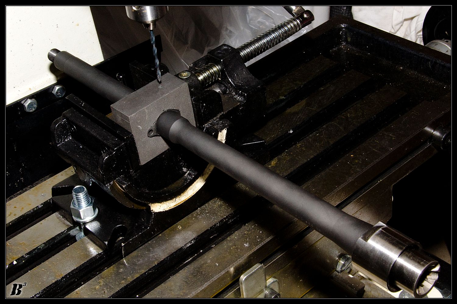

    Chaz...the tool you're referring to is a jig used to drill a hole for either a straight pin or a taper pin. There is a link to detailed directions with photos on the product page for the jig on Rainier's website located here: http://www.rainierarms.com/?page=sho...roduct_id=1398 just click on "Download Installation Guide" at the bottom of the product description.
    I have one of these jigs from Rainier that I modified slightly so that it fits around other low-profile gas blocks. I use it regularly. The jig allows you to drill the initial hole through the gas block and barrel...which is only the first step. Next take the jig off and ream the hole for either a straight pin or a taper pin depending on your preference. I have used both straight pins and taper pins. Using a taper pin takes a bit more time, because you have to ream a little, then test fit the pin.
    Here a few not so great photos of an upper I did using a taper pin...
    The BRDE jig from Rainier Arms...
    The barrel and low-pro gas block in the jig mounted in my drill-mill set up with a #31 drill bit for the initial hole...
    With the initial hole finished, you remove the jig, line the new hole up with the #31 drill bit, then replace the drill bit with a 2/0 taper pin reamer...
    You ream the hole slowly and fit the taper pin...and you've got a pinned gas block.
